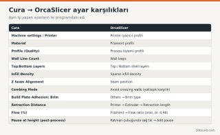

Ayar karşılıkları
| Cura | OrcaSlicer |
| Wall Line Count | Strength → Wall loops |
| Top / Bottom Layers | Strength → Top / Bottom shell layers |
| Infill Density / Pattern | Strength → Sparse infill density / pattern |
| Z Seam Alignment | Quality → Seam position |
| Combing Mode | Quality → Avoid crossing walls (yakın karşılık) |
| Support Structure: Tree | Support → Type: Tree (auto) |
| Build Plate Adhesion: Brim | Others → Brim type |
| Spiralize Outer Contour | Others → Spiral vase |
| Pause at height (eklenti) | Önizlemede katman çubuğuna sağ tık → Add pause / Add color change |
